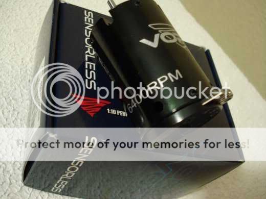

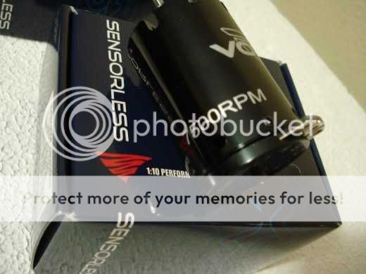

Motor Orion Vortex SL 7500KV Sensorless Brushless
7500RPM/Volt
4/6 cell NiCd/NiMh / 2-cell lipo
70A continuous - 90A peak
50x35.8mm - shaft 16mm
Motor Orion Vortex SL 6400KV Sensorless Brushless
6400RPM/Volt
60A Continuous - 80A peak

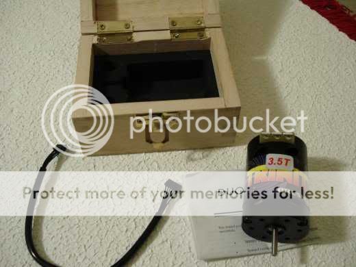

Motor Brushless 3.5T Trinity DUO Sensored, acompanha cabo, compatível com ESC Sensorless

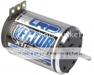

Motor Brushless 4.0T (8600kv+) Vector X11 Sensored da LRP
