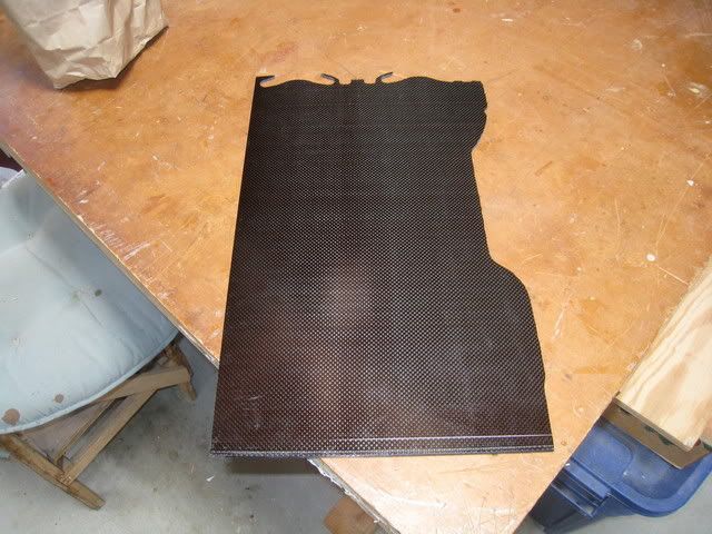

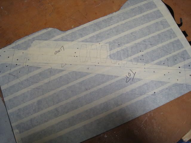

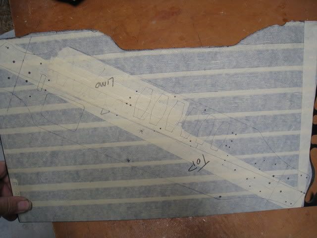

Took a sheet of cf and did some layout on it using a Drift Master chassis for hole reference.

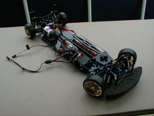

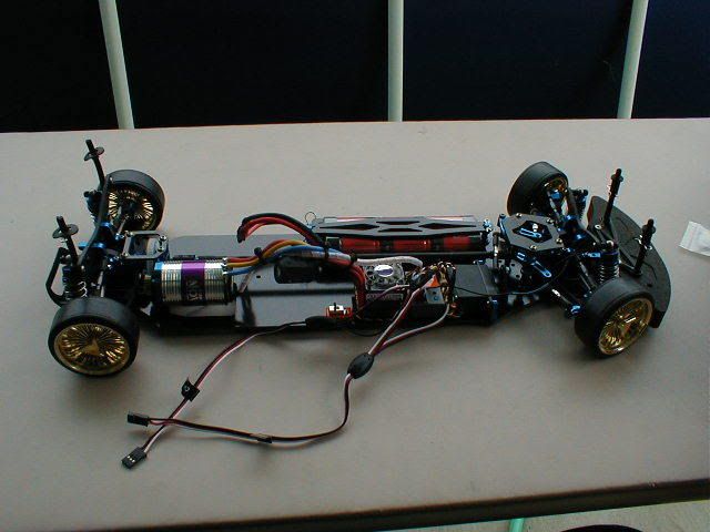

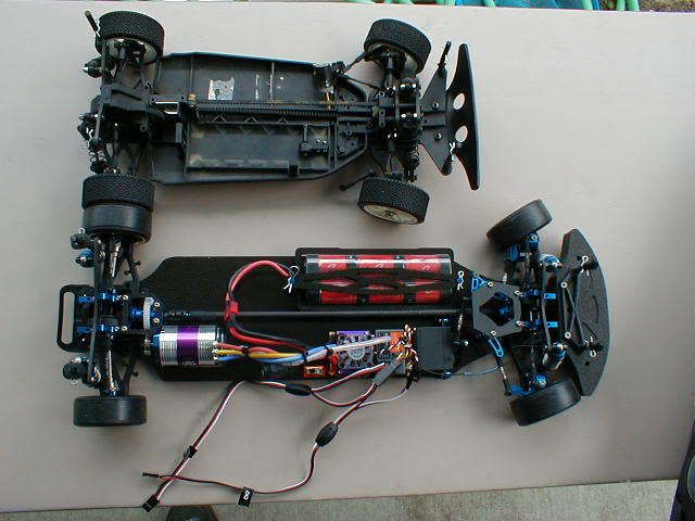

Then just slapped the parts from the same Drift Master kit on the finished chassis with a Novak 8.5 Pro System and my DSM receiver.
As showing the amount of stretch compaired to regular chassis.
For those who want to know where the longer center shaft came from, I made it out of a cf arrow shaft and Yokomo shaft ends.
Thanks for looking.

Uma bela distribuição de peso kkkk,tudo concentrado na parte da frente!
Vai ter que chumbar* a traseira pq desse jeito ai no drift fica uma merca!!!!
