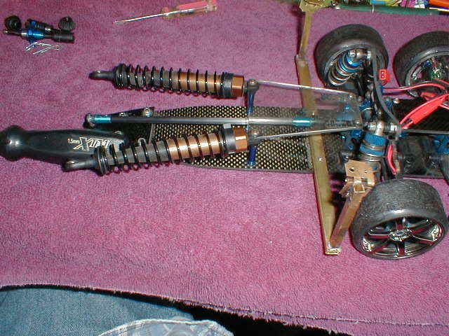

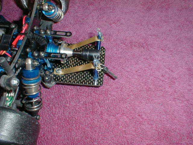

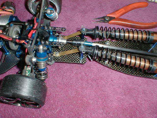

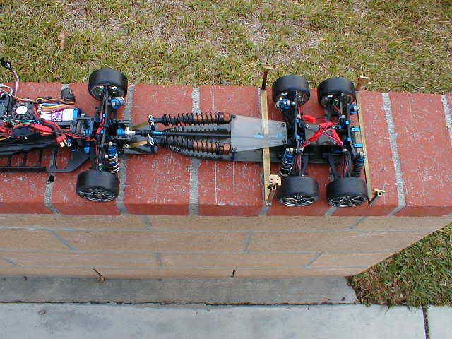

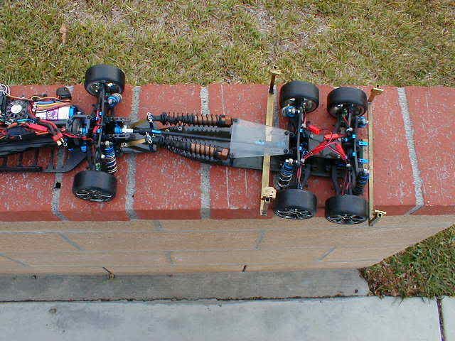

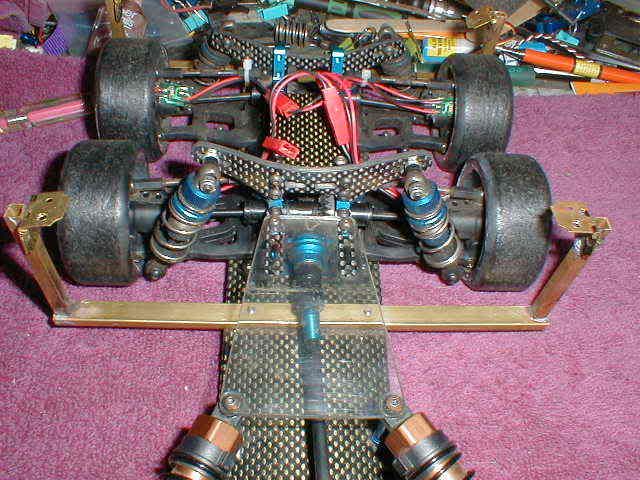

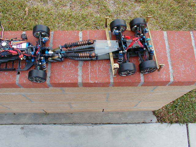

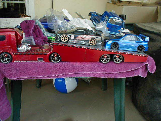

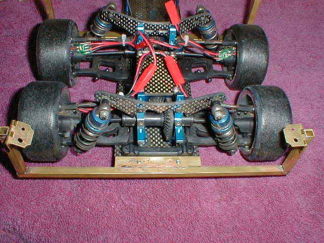

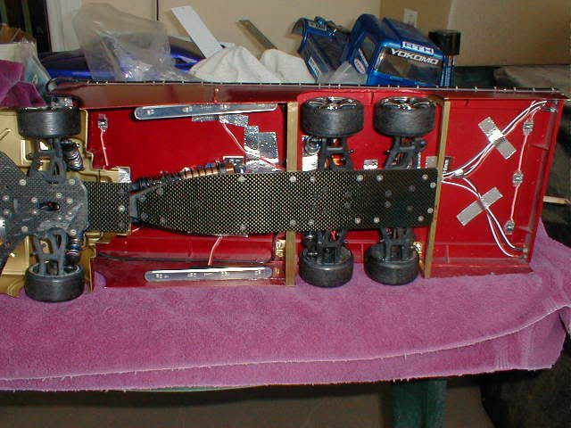

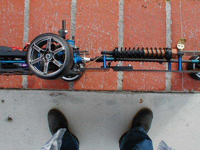

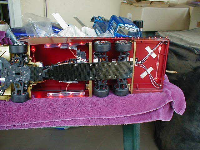

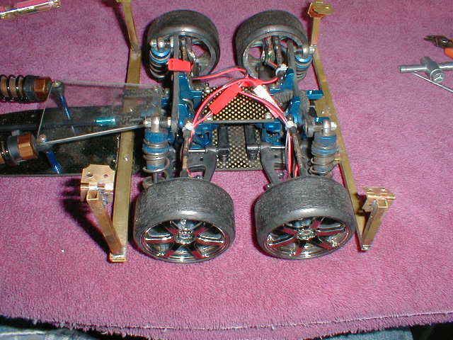

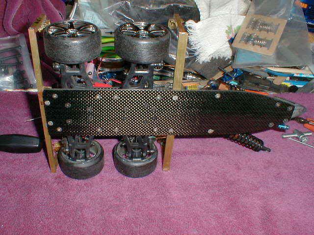

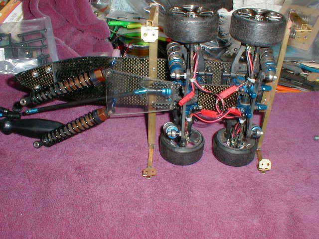

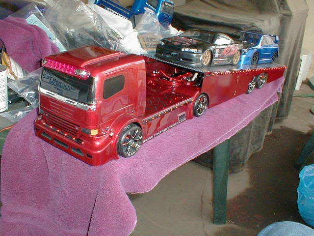

J.C. escreveu:
Ok, as promised, here is the trailer, basicly hand made. I think the pictures speak for themselves.
I welcome questions.
I have brought up this picture of the Truck outdrive so you can see how it fits together.
Now with the driveshaft and shock/swing limiters attached.
I took the setup back out to the brick wall so you can see just how much swing the trailer has. Take note, I am only swinging the trailer as far as it takes to encounter the resistance from the shocks. The shocks are fully functional and can swing farther than this when under the stress of say, smacking the wall.
You can also see the amount of drop to get everything as closely lined up for the least troubles.
Back to the bench for finish assembly.
Now that this has been, shall we say, taken from the closet, I will continue to bring it out now and then to keep the dust off it. I do enjoy running it although I do have to become a better driver to make it around the Arai tracks, I will run it when we have sessions outside of Arai.
Keep a weather eye on the horizon for more "off the wall" driftable equipment from me, I have several ideas.
Hey, thanks for looking!
